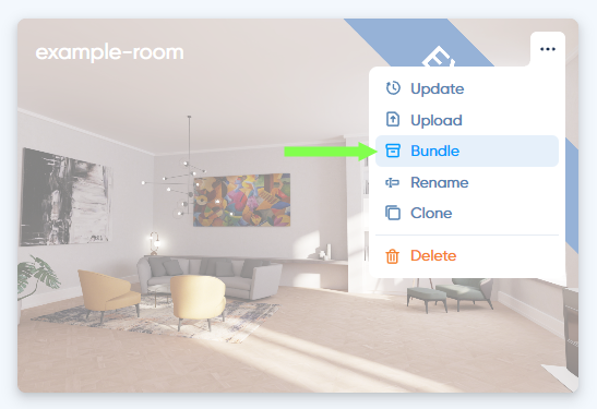

Shapespark gives you the option to host scenes on your own web-server. With the Premium plan you can create a bundle of your scene which contains all required files - HTML, textures, JavaScripts, etc.
These files are zipped and need to be unpacked before or after you upload them to your server. If you use the FTP protocol to upload files to your server, make sure to use binary FTP transfer mode. ASCII transfer mode can corrupt the files. The uploaded scenes should work out-of-the-box but we have some web-server configuration recommendations to improve download speed and user experience, which is important if you want to share scenes with a wide audience.
The bundle with an example scene you can find below as the attachment (example-room.zip).
