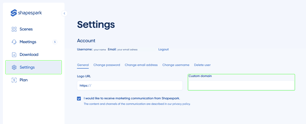

(the trailing dot may be important). - In https://cloud.shapespark.com/#settings enter your subdomain (for example '3d.your-company.com') in the 'Custom domain' input:
DNS changes may need some time to propagate so please be patient, your domain will be activated within hours.
