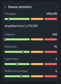

You can see how many triangles your scene has in the Object’s Tab. The information is in the Scene statistics panel and may look like this. (These are scene statistics taken from the example-room scene).
As you can see the triangles count was reduced from 1,175,590 to 490,195 - which increases the performance of the scene significantly, especially if you want the scene to be viewed on weaker mobile devices.

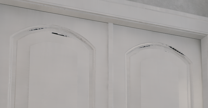

Lightmap distortion
This happens because the simplification is done after the baking, this means that sometimes the UVs may displace themselves and as a result create these kind of black patches. The way to fix this is to lower (or disable) simplification for the object that is affected by this side-effect.

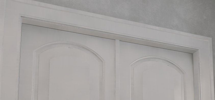

After lowering the level from High to Normal this artifact disappears as seen below:
Note that in some cases you may need to use even lower levels or even disable the simplification for the object altogether.

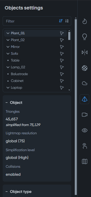

- The Objects tab lists objects sorted by their triangle count, so the most complex object is at the top. You can see the number of triangles of the selected object in the Object panel.
