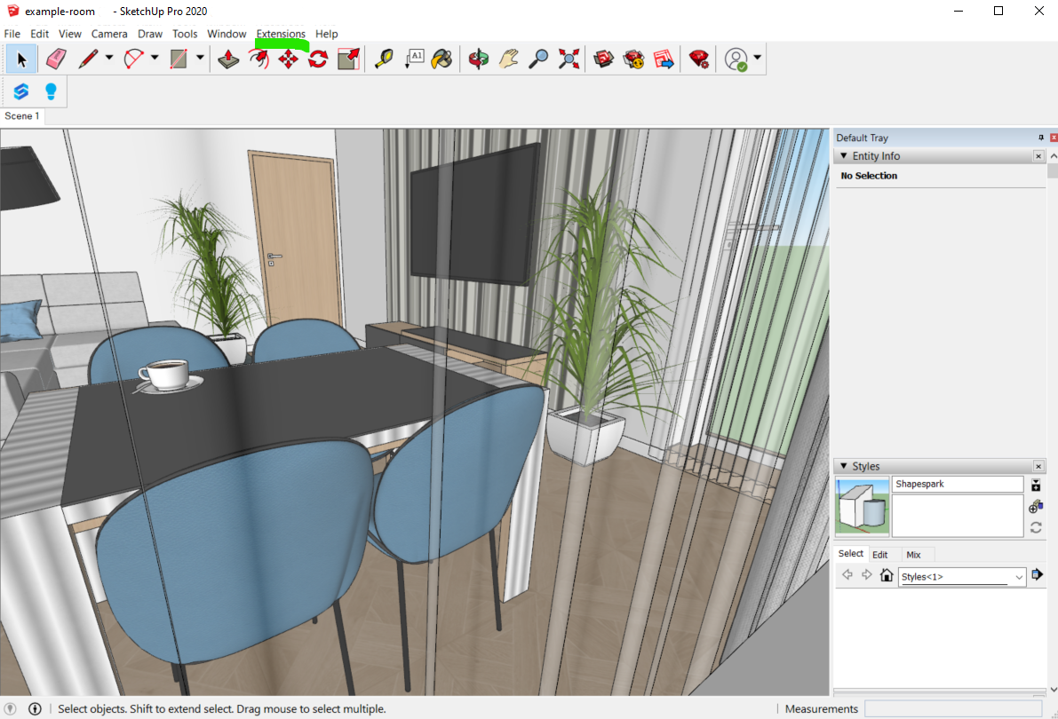

Open the export dialog using the Export to Shapespark button from the toolbar or the Extensions > Shapespark > Export menu item.
Importing models from SketchUp is handled through a dedicated SketchUp extension which is accessible from the SketchUp toolbar:
or from the Extensions > Shapespark menu:

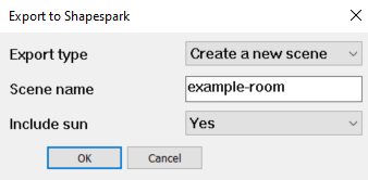

Configure the export:
- Export type - Determines whether a new scene is created or an existing scene is updated.
- Scene name - The name of the scene in Shapespark.
Include sun - If enabled, the SketchUp sun is exported. The sun shadows in Shapespark match SketchUp shadows.

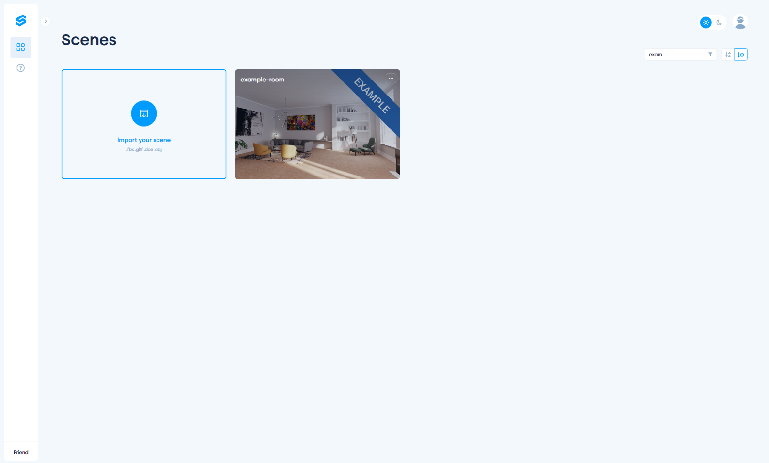

Start the export and wait for it to finish.
The exported scene is now added to the list of scenes in Shapespark.
