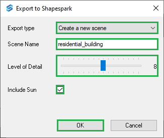

Configure the export:
- Export Type - Selects if a new scene is created or an existing scene is updated.
- Scene Name - The name of the scene in Shapespark.
- Level of Detail - Controls how parametric geometrical objects are transformed into Shapespark's triangle meshes. The higher the Level of Detail, the more triangles the objects have, which makes the objects smoother but also slower to load.
- Include Sun - If enabled, the Revit Sun is exported.

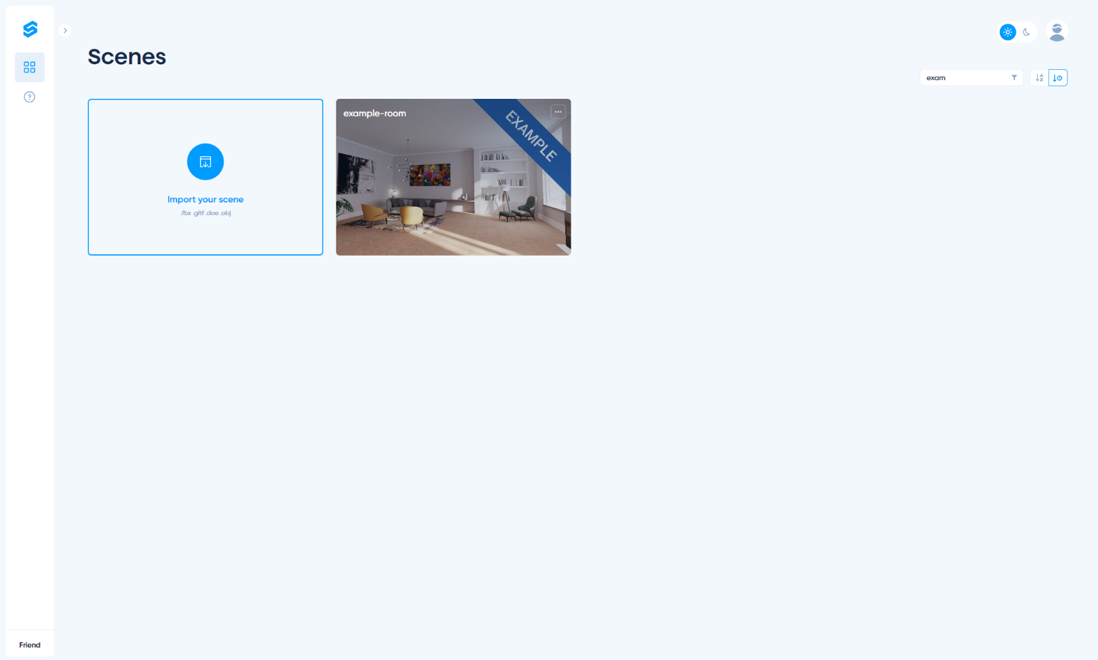

The exported scene is now added to the list of scenes in Shapespark.
