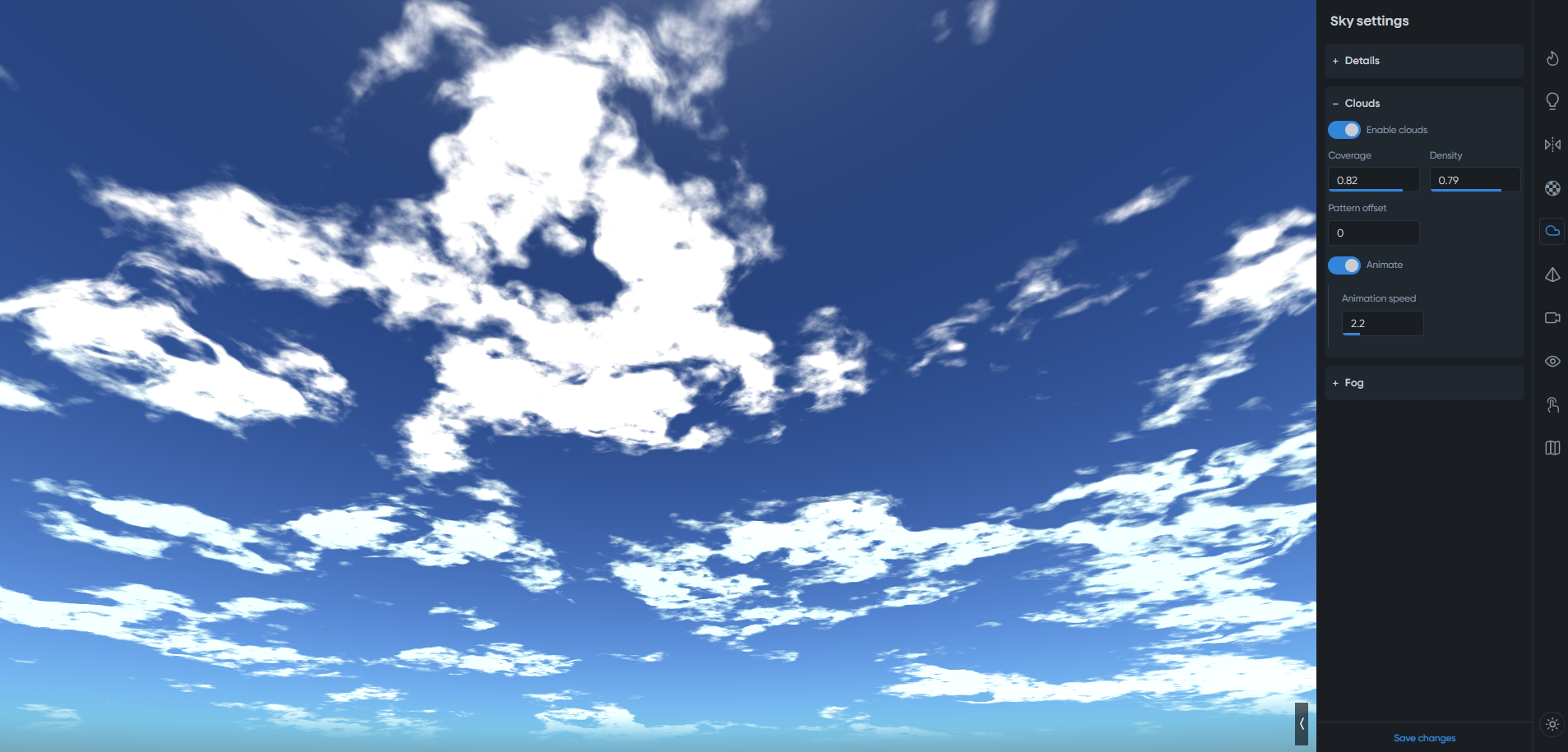

Clouds
When the Hosek-Wilkie model is used for procedural sky generation, the Clouds settings allow you to customize the appearance and behavior of clouds in your scene.
Coverage
Controls how much of the sky is covered by clouds. Higher values increase cloud coverage.
Density
Adjusts the thickness and opacity of the clouds. Higher density makes clouds appear thicker and less transparent.
Pattern offset
Shifts the cloud pattern, allowing you to change the position and arrangement of clouds in the sky.
Animate
Enables cloud movement. When active, clouds will drift across the sky, simulating natural motion.
