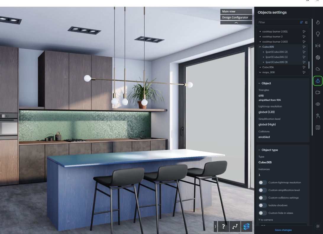

Objects hierarchy list
The hierarchical list control in the Objects tab allows the hierarchy of objects to be inspected. The list can be sorted:
- by face count (objects with the most faces first) - this sorting helps to identify the most complex objects that may be optimized if the scene is too large
- alphabetically
The selected object is marked in green 🟩; objects of the same type as the selected one are marked in orange 🟧.
Object information
The following information is displayed for the selected object:
- Faces - The number of triangular faces the object consists of
Lightmap resolution - The effective lightmap resolution of the object. It may differ from the global Lightmap resolution set in the Bake tab because:
- this object or some of its parent objects uses Custom lightmap resolution (see below), or
- the resolution has been automatically decreased to satisfy the Max lightmaps setting in the Bake tab
- Collisions - Whether collisions are disabled for the object (see Custom collisions setting below)

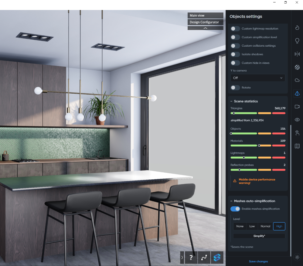

Scene statistics
Scene statistics show the total size of the scene geometry (the number of faces and the size of geometry buffers used by the GPU).
