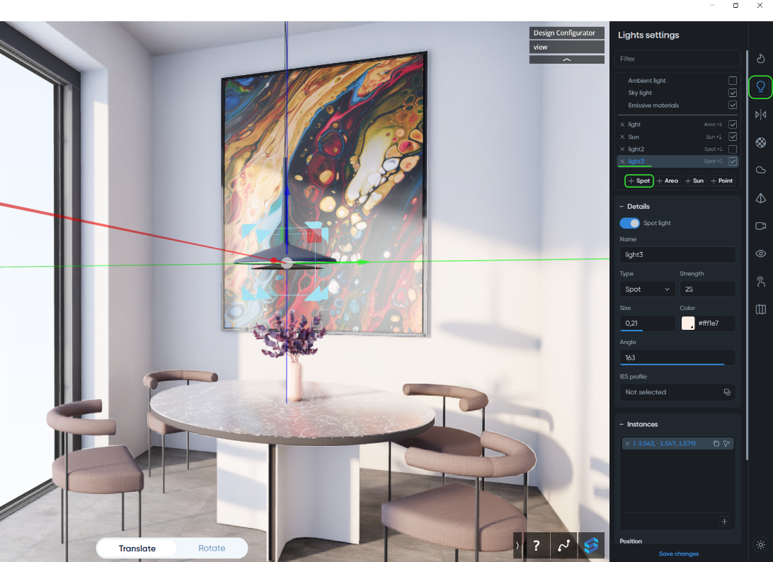

Adding lights
- ➕ Spot, ➕ Point, ➕ Area buttons -Adds a light of the given type. An instance of the light is placed at the current camera position.
- ➕ Sun - Adds sunlight. An instance of the light is placed at the zenith point of the sky.
ℹ️ Lights can also be imported from a 3D modeling program. This method is usually more convenient than adding lights in the Shapespark editor, because it allows light sources to be attached to 3D objects, such as light fixtures.
❕ 3D model lights are imported as Shapespark Spot lights, but the type can be changed in the Shapespark editor after the import.

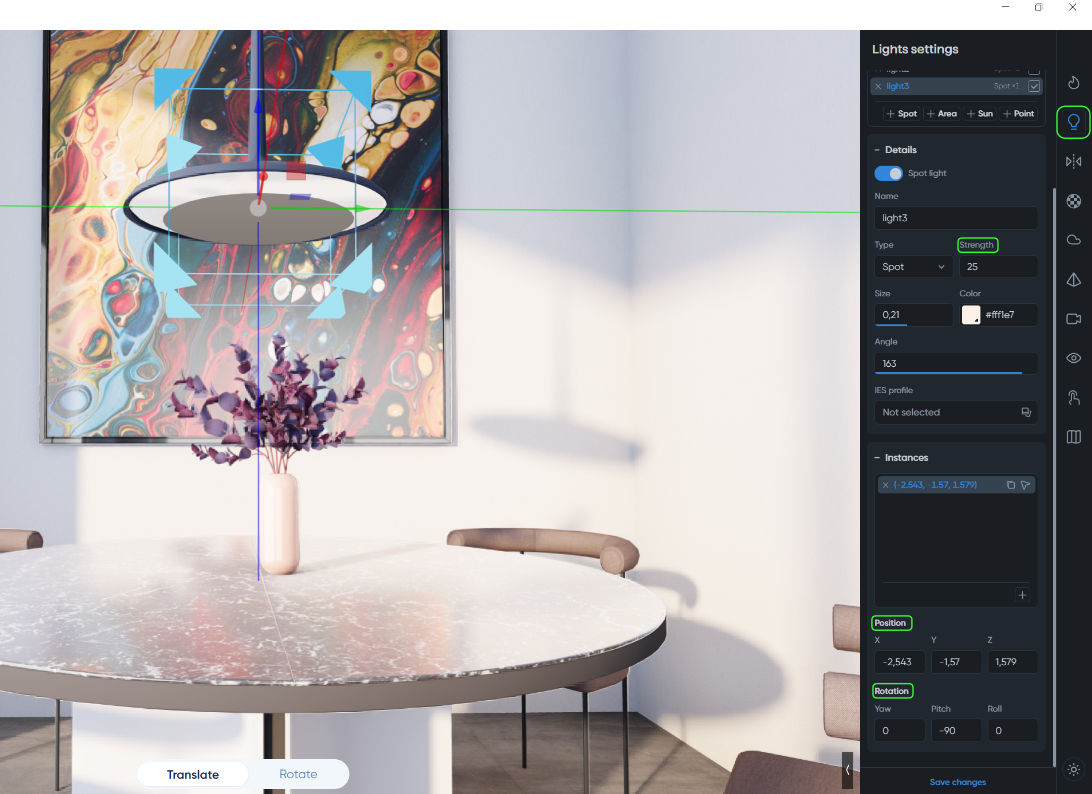

Light properties
Lights have the following properties:
- Strength The light strength
- Angle For Spot lights only: the light beam angle
- IES profile For spot and point lights only: an optional light profile containing photometric data in IES format. Can be imported from a file with the 🖺 button
- Size or Width & Height The light size in meters. Larger lights cast softer shadows, smaller lights cast harder shadows. Depending on the lightmap resolution, excessively hard shadows can result in a pixelated lightmap
- Color The light color
Light instances
➕ button - Adds a new light instance.
The Position and Rotation of a light instance can be changed either with the numeric controls in the editor panel or with the gizmo in the 3D viewport.
